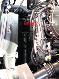

install was pretty straightforward, but I have to warn, dont even attempt if you dont have access to a lift & impact gun. I had to disconnect the steering arms on both sides to get my socket in for tightening on the ladder brace (you'll see below), & I had to bend a line at the front for clearance of the front bar (no bigee).
Otherwise, they went on without any fitment issues. The hardware used to put the insert in is pretty ingenious. JC posted the vid on page 29. That was fun getting those in, & that's also where you need the impact gun, unless of course your name is Arnold :rofl:. I'll have more to say later on, but for now, if you're thinking about kicking yourself for not fetching a set, . . you probably should.
I needed to disassemble for clearance (Shit was tight, but nothing a small sledgehammer couldnt break free :zip:
