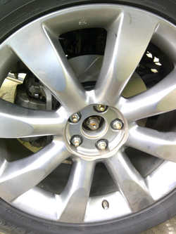

The SS Debacle has officially sailed! To be honest, I'm glad to see the bitch go. :tongue (2): Installed are H&R 20mm DRS spacers and ARP wheel studs at all four corners. It looks good, I feel good about it, and my center caps still fit. Unless H&R decides to make a 25mm DRS spacer I am not even going to consider changing this setup again.

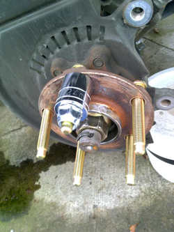

When installing the new wheel studs, one way to "press" them in is to thread the conical lug nut backwards and tighten it down to pull the studs into place. For the sake of my limited socket depth I had to also use another large socket as a spacer, like this:
The new studs are so tough that my impact wrench actually started to pull the lug inside out, and even then the studs weren't fully seated. I had to torque down the wheels several times in order to seat the new studs. The "seating nut" is on the right and a new one on the left for comparison. If you choose this method, plan on destroying at least one nut.

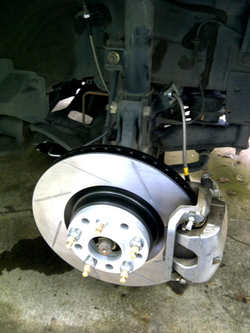

Studs mostly seated, new R1 Premium slotted rotor installed.
New Stoptech pads installed.
I didn't want to drive all the way to the parts store for a caliper piston spreader so I used some flooring shims I had lying around to create enough of a gap to get the new pads onto the new rotor. It worked fine.
Pads, rotors, spacers, Stoptech lines, and lugs installed. Final torque down to seat the studs.

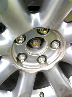

This is how much the WRX studs extend beyond the 20mm spacers when fully seated. Plenty of room for the oem center caps and enough for thicker spacers in the future if it comes to that. Not that I'm planning on thicker spacers...
