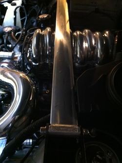

Waiting for tune, another bay image, really like the Chromex coated intake. Going to get me a folding chair and a six pack of bud and sit by the open hood this weekend......The last (well maybe not last) dress-up dealeo is going to be to toss the plastic water catch and install my Weapon R aluminum unit.
