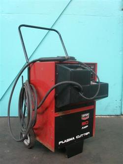

so now that I got a nice tig for the shop & I took the dynasty home... now I need a big plasma cutter for the shop so I can take my little plasma cutter home too :) been looking & looking for a good deal & finally found one. I picked up a snap on YA5550 50 amp plasma cutter on ebay :) another kick ass machine, can cut through 1" steel, got a score on it too at ~$350!!, another $4,000 machine new... haven't got it yet but this is what it looks like...

I haven't even picked up the other plasma cutter I bought yet, but now I'm going to look at another one today too :err: I was working on the bigger 80 amp thermodynamics one before, but it didn't look like it was going to go through so I just grabbed that snap on one since it was such a good deal, but now the other one may have come through after all so I may wind up having 3 plasma cutters by the end of the day :laugh: anyone feel like cutting there fx into pieces we can do it really quick with 3 of these things going :tonguey:
