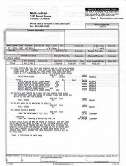

Just be firm and tell them about the sprak plugs problem, I mean the least they should do is to replace your valve cover. That's what I got in the first place.
At first they want to do a oil consumption test before doing anything. Then I talked to the manager I am sure the valve cover was causing the problem, he said it is quite common about it and ordered a new valve cover and gasket. But I am not sure about the dealers in Canada.:confused:
oh................I get it now!
then the second row was saying the reason to do so was to change out the plugs the next day.
hahahaha........Lesile, u got me thinking~
this dealership is funny, they actually explained what work was done in paragraph format and in the paragraph they stated they didn't wash or do any detail work to the car. I think I am ok if they actually detail my car~:tongue:
But they charge you $10 for loaner.............
Got the valve covered replaced by the dealership. However, about the leak at the front plug, the rep said nothing but insisting the valve covered is fixed. So, I will keep monitor and probably change to another dealership in about two months.
