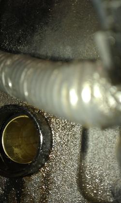

What do you know, same thing happened to my VK45DE. I changed my plugs at 100k miles, and no issues.
Now at 130k miles, I wanted to switch and try iridium vs platinum plugs -- and I found a big mess.
The platinum plugs were also worn out after only 30k miles.

So I bought the 2003-2005 Maxima valve cover and it arrived today. I don't see how I can take apart the valve cover to take the spark plug gourmet out of it to replace the worn out one in our FX. Sigh, there goes my idea of saving some $$ to be use on other mods :smile:
Is the gasket sandwiched between the two halves of the welded cover? How does it look like it was put there initially?
Yeah, it is a gasket that is sandwiched between tow halves and welded together. I try to pry at the grommet with no luck. It does look like the grommet was put in place and then the other half welded over it.
That is super dumb. What a wasteful design... :tdown:

I have seen a post on the G35 forum did that, drill out and use some other gasket there. I don't feel warm and fuzzy doing that hack job in there. Too much risk there! So I'll bit the bullet and just place an order for the left & right valve covers and gaskets. Order total to $397.79 free shipping.

so if theres oil in the spark plug area, just replace the valve cover and valve cover gaskets?
If oil is found in the spark plug well/hole then yeah, you need to replace the valve cover and gasket. I did both sides of mine three weeks ago. Easy job, just take times.
