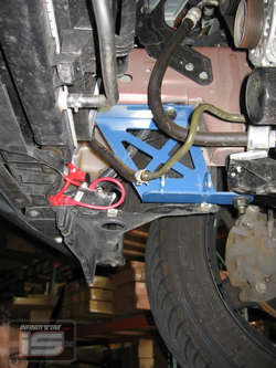

As promised, here are the pics that I took while I was @ GT Spec so they can test fit the 4 point lower brace and the under engine tie brace. I got there around 12:30 PM thanks to NY traffic but it was well worth it going all the way out to meet with these guys.
It took us (yes, I helped .. :tongue:) about 5 hrs to get everything done. We didnt have the proper bolts for the 4 point lower brace so it I did not make it home with me :frown: but the good news is that it lined up properly and according to Ken, after today, it should only take 2-3 weeks till they get them in stock.
I just wanted to thank the guys @ GT Spec for taking the time to test fit this product before they sell it to us to ensure proper fitment. Noah, Mark and Ken were not afraid to get dirty trying to install these pieces on my FX. Kudos!!!
This is the "rivet" that goes into the chassis so that it the brace has something to connect to, as you tightened the long bolt it compresses and locks in to your chassis therefore it will be on there permanently.
