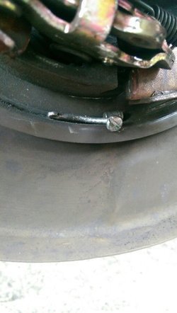

I went to release the e-brake at school today and heard a "pop", which was followed by a completely loose e-brake pedal. No problem, I thought. Probably just a broken cable. Then I began to reverse and heard the most godawful crunching sound followed by scraping and screeching. Ugh.

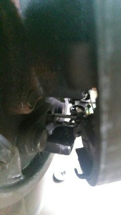

Being in the parking garage at school with no tools, I got out to investigate and found nothing. E-brake was intact, rotor was fine, pads were fine. I came to the conclusion that something in the e-brake mechanism exploded, so I soldiered on and endured the awful screeching for the 7min drive home. Jacked up the car, pulled the rotor, and found this.

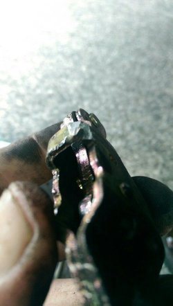

It appears that the either the clip holding the pin into the lever below the hub popped off, or the left pad spring retainer came off. Regardless, it set off a chain reaction that mangled every small part save the springs.

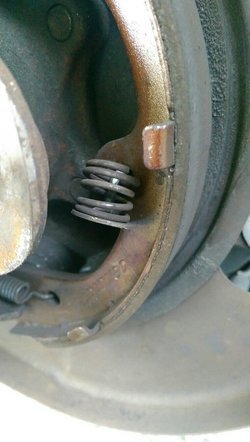

Total carnage:

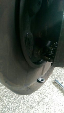

Fortunately nothing broke and the parts that were bent were steel, so I was able to reshape them, anneal them with a torch, and reinstall. Just returned from the test drive and all is well.
