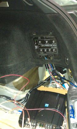

My gas door latch seized to open this morning and this blocks the access to the cubbie hole to manual release the latch from inside the trunk.
What a pain. Now I need to figure out where I should relocate the signal processor.
