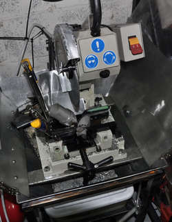

well I now started to build my headers & let me tell you, it is absolutely impossible to get it really the same, ESPECIALLY considering the fact that now, I'm actually getting precise, square cuts... before was just a crude jagged chop saw cut, then grinded to the angle I needed for it to line up... but here I'm now trying to get all "proper" seams for better flow, not nearly as much "cheater" bends as I winded up with the first time, & have all nice & square joints... the cold saw with clamping jig insures I'm getting square cuts but now trying to do this with my jig was just turning into an impossible exercise in frustration.... I realized this past weekend that doing it with the jig I built is impossible.

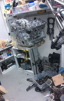

since my header mishap & then thoughts of the tranny swap I have been on the look out for another spare motor, really my main intension for getting one was more towards facilitating the building of the tranny swap more than anything else, at that time I thought the jigs would be good enough to build the headers, but now, since I have found a spare motor anyway & the jig isn't working out as I had hoped, I now decided to take the spare engine I had all apart & bring that home, build it back together with the block, heads & front cover on a bench in my garage, & now, I can build them the right way, just like the first time, built right around the engine itself. I'm finally, after all this time, feeling confident & really good about this project again... it's been a year of frustration but I now finally think I really have what I need to do this & do it right... I'll be building brackets for the turbos right on that mock up motor then building the headers again, this time so much better than even the first time...

I had to make a new jig for these slant cuts & I had to remake a new blade guard to allow the cold saw to cut deep enough without interfering
