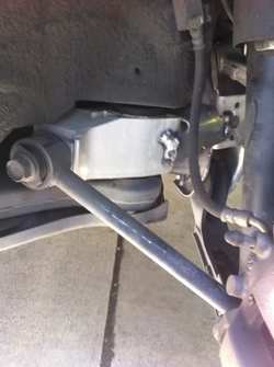

Have you guys ever replaced the rear radius rod? Did u guys feel a difference? number 7 in the pix
No, but there is a bushing on there. If you are over... 150,000 miles I probably would change it.
i got 84k, noticed the radius rod busing is cracked, but im trying to figure out will these affect handling, besides maybe some clunk. Also its pretty tight in place no looseness when i inspected the rod.

Cant see really well on this pix, that i found on my old thread

Pull it off and see if you have any corrosion and verify that you still have a uniform range of movement. If it looks and feels good, I wouldn't worry about it. It looks to me like that bar maintains the toe angle, so if the bushing is shot you should be able to move the wheel back and forth by hand (placing your hands on the tire at 3 and 9 o'clock and pulling with alternating hands). If it were corroded (most likely with a cracked bushing), then it would make noise. A creaking/squeaking/grinding noise when you accelerate or decelerate. If you can see metal through the crack, replace it asap. Either way it's not really a safety issue as the mounting bolt will hold everything together even in the event of a total joint failure.
It's only like that on 1 rear corner?
If you pick up the back, (like on a lift), and tug each of the wheels around, can you feel that side looser?
Tie rod bushings are common replacements, but I really don't hear about them on an Infiniti.
EDIT: yeah, what tchuck says ^^^
