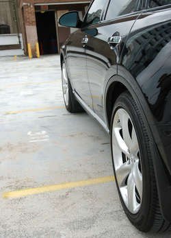

I have fx50s wheels with ichiba v1 15mm spacers (front & rear) on Gen1. no issues and needed to clear the fx50s bbk (*edit: for oem 20's).
Ichiba site: http://www.ichibausa.com/fx35fx45.html
pics are about 4 months old:

I would guess u'll need 20mm to have the flush look. I'm sure someone more knowledgeable can chime in.
