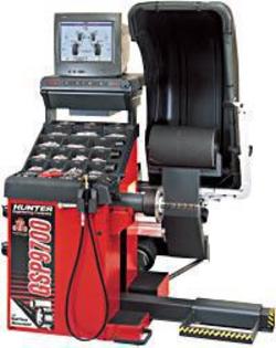

2) http://www.gsp9700.com/ I make sure I get my wheels/tires Hunter Roadforce. This gives you a number reading, the lower the better. For a set of wheels, you can get like 0, 3, 5, 10. If you don't get two really low numbers -- have them re-do it. Then put the lowest numbers in the front.
