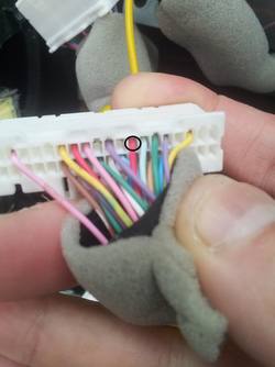

I decided to go with Saleen's second way just so I could get all the functions. I grounded the purple wire and then just cut off the VSS wire from the other plug that seemed to resemble my unit the most. I didn't do a switch yet because I couldn't get one yet but I could always just go back and install it. What I found is that my plug has a lot more wires than Saleen shows on his post. The circled wire is what I presume to be the VSS that resembled saleen's picture and went on and cut it.
So now I have my E-brake wire grounded and VSS (second way) cut and taped but it still won't allow me to watch DVD. I'm assuming the extra wires going in the plug is what's disabling the DVD. Could someone help me with this?

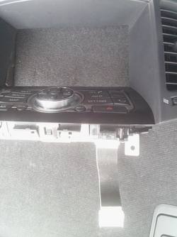

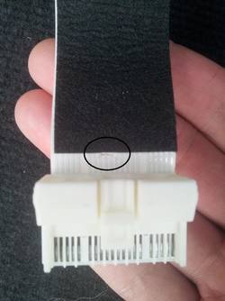

While removing the plugs from the connectors I managed to poke a hole in one of the tape wire with a small flat head. Yes it was a Oh FUCK moment because I didn't know which buttons it would affect.
From this Unit:
So all the other buttons work except the CAMERA one. I have no way to tell if the camera mod has been successful right now. The only way that I can get the camera to work is when I go in reverse. Does anyone know the part number for this? I'm gonna have to order me a new one.

I'll just post the two connectors side by side to see the difference.
Saleen's Connector:
My Connector:
40pin Connector from this:

I connected back the wire that was cut from the 2nd way and I tried the first way but still no luck here. Video still won't play when stationary+ebrake on just like it was when I got the car brand new. I suspect other wires that are disabling the system but I don't got the balls to try each one. Please HELP ME!!!

I DIY'ed the tape wire that I poked a hole in and now the camera button works. Camera mod works now (at all speeds) but still no video.
