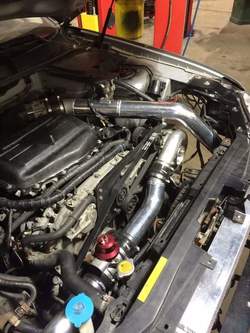

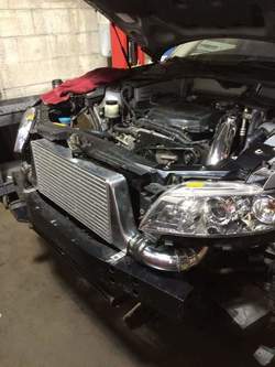

Tune in Friday
Vortech v2
I got shipped the wrong pully so waiting to hear back from 928 motor sports
Dc headers
Kennetic plenum
Tb spacer
Transgo shift kit
Akebono
Will throw on bc coils when the salt is gone

I think my last post got lost when the site issue happened. I would definitely not use that plenum with any FI system. It tends to flex and bend under the pressure, and I have seen a G35 blow one of them completely.
Just use your stock plenum with a 5/16 spacer.
yeah we'll see on the dyno Gona ask what my buddy thinks as well he's worked on a lot of vqs
inwas orignslly only going to do bolt one but got a deal on the sc so it's. A bit of mix match
