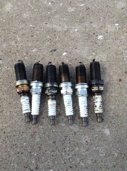

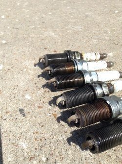

Changed the plugs last week. Normally, someone would be satisfied after completing a spark plug change... But...
Looks like I need a pair of valve covers lol
Left to right: 1,3,5/2,4,6.. Thought the passenger side cover would be good, then I get slapped with plug #6 lol
