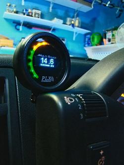

Permanently mounted. Bought a PLX Devices 52mm Gauge Mount from Amazon. Butcher it up to fit there, paint it flat black, cut off the 3.5mm jack/receptacle wiring and wire it up directly due to very limited gap when the cluster is in rest position, take off the cluster, drill two 1/16" holes and mount the gauge. I wish the gauge is dimmable. I think I need to put some window tint on there.
I have thought about mounting it in the bezel next to the clock too, but the mounting arm of the clock stretch pretty much the entire width of the bezel. At first I wanted to mount it in the ashtray location, by removing the ashtray and make my own bezel to fit there, but the hazard switch is attached to the ashtray as one assembly.
Hmmm, bad news about the clock arm, I hadn't pulled it off to see the back yet.
Do you think tinting the screen will affect the touch screen functionality?
