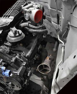

test fitted tonight... it all fits togeather nice, plenty of room for everything. once the headers & downpipes are finalized I'll drop the motor back out to paint everything else...
the equal length stillen headers are just too big & raise up the turbo's way too high. I think I'm going to have to go with these, there much more compact & fitting everything else will be easy. I've talked to a few turbo guys & the answer I'm getting from most is that equal length is a help for NA but not much difference when it comes to turbo anyway. I'm tempted to try & chop up the stillen headers to try & make them fit though :tongue:
