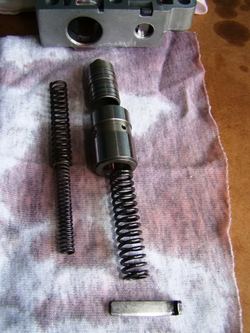

Smooth sailing all the way. The only difference between his 45 and my 35 is the spring use in the Check Boost Valve. Per Transgo installation instructions, you need to look at the Check Boost Valve type you have in your valve body to determine which spring from the kit to be used.
FX45 uses the "Plain" colored springs from the kit.
FX35 uses the "White" colored springs from the kit.
