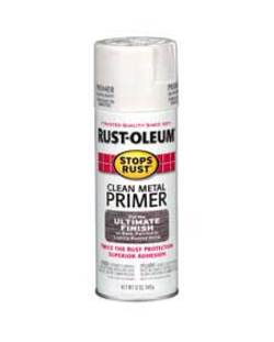

I went to Auto Zone to look for 3M primer.. they didn't have any.
The rep told me this would work:
I just removed my emblem and sprayed it with this stuff... my emblem is now white for now.
Are the 3M primer and this primer entirely two different things?
Oh no the primer you got is not for wrapping purposes. As Zebra said, the 3M 94 Primer is designed for wrapping purposes. I used it with my interior wraps and it does improve the adhesion where the primer was applied (corners and edges).
