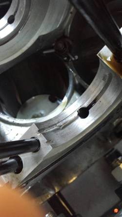

Me too buddy.....me too. So final verdict:
* rear cranck bearing blown
* 2 rod bearings blown
* 2 connecting rods damaged
* cranck wasted
* short block wasted due to the bearing that made unrepearable damage
* pistons can be saved but close call
* camshafts doesn't seem to make it. Trying to polish them but there is already some wear
* tranny debatable.... oil was burned... metal inside wich was on my magnetic plug and the TC had quite some movement on it when i pulled it up and down.
Now outter then the oil wich started something our thought is the tranny failed and the TC due to extreme "wobbling" blew my rear cranck bearing and then the rest followed.
Again the cause is not 100% findable but the result is there.
I told myself i would stop if this engine would die on me again but must say have been offered too much help in both material and labour by my engine builder to just walk away from it now.
So version 3.0 in progress.....now with the right oil.....maybe oem cams cause i'm not spending another 1K+ on some cams for the third time but with a Manual Transmission behind it. Checking/repearing my A/T is costing too much comparing to a M/T and if i would have repaired it i'd still have the issues it couldn't handle the power.... again. So back inside she goes....taking my time again cause i do not have limited funds to take care of this right away. Tranny isn't the issue but twinplate clutch etc... is.
