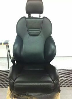

I'm right now and don't know how to copy links into this. But i put some intel into my "Ray's winter projekt" thread along with the blue interior led lichting mod. I used something of both frames of the chairs to make. So upper half of the RS4 seats and lower half from the FX with mounts to the car body. I could then use the electric seat adjustment of the audi seats and slight foward and back with the FX seat rails and motors. Only functioned i didn't have was the seat heating as the FX has 2 options and the audi works with a so to say spinning wheel wich you can adjust from 1 to 6. Today i received a after market wiring loom so i could mount the audi heat adjusters knobs and fit all oem audi connectors wich till now i custom wired to the FX wiring system. Don't do this for performance reasons cause both seatframes frankensteined into one isn't going to make it any lighter......LOL.Haha I don't think that shifter is gonna break ever like that... Nice work.
Ray have you ever detailed the install of your RS4 seats? I have an opportunity to purchase a set of RS4 seats for really cheap, and the condition is really good. Was how hard was the installation? Do your seats work just like normal? How about the memory functions?
But i love it......that i do.....they realy compliment the FX well.
