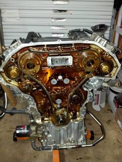

Ok just trowing this out here cause i cannot seem to find any thing on google in why my main timing chain was tensioned so extreme hard by the left tensioner and its guide ( when standing in front of the engine). Only discussions i can find is about the VDC side chains and the tensioners there,but none on the main chain outter then the guide breaking sometimes.

That tensioner on the left is the only one that I recall seeing. Not sure how any slack could exist in the system if its the last step in the install. Was the upper guide or water pump replaced after the tensioner was installed?
Here's a shot of mine:

The tensioner in the red "circle" was the one that was fully extended and created extreme tension on my main chain and therefor sort to say pulled the front of my cranck upwards.
The tensioner in the green circle ( i think not mounted in your picture so to see ) is the one that often fails and creats slack on that chain causing it to rattle when you start the engine.
My main focus is on the main chain issue. I found the the guides would sometimes break but i think that was not the case in my situation. Have to double check that. Still if so, that wouldn't cause the tensioner to extened fully like that.
Right, we're talking about the main chain tensioner. I just don't see how it could over-extend. Its the only tensioner on that chain, is not adjustable (spring loaded), and everything else in the loop is fixed. Its not like the belt system where a person could actually tighten the tensioners too far, causing excess lift on the crankshaft...

Sorry about my late reply. We took a closer look and i talked to some engine builders as well. It is still not a 100% certain but it more and more looks like my engine had a back fire. Most likely happened with the Tune but nodoby told me off course. So the new theory is due to the back fire at a certain point there was slack created in the main timing belt. The main tensioner is not oil pressured and has a certain lock up system. So once it extens a tooth it locks up and cannot go back anymore. IMO at the time the chain slacked the tensioner extended maximum......after a split second the chain came back at its original position and got tightend extremly. The way we could see the damage was done due to the chain being way to tight was that the front of the cranck was more out of line ( wobbeling) then the back and the same with the cams. Cranck was pulled upwards and vdc sprockets with cams downwards damaging the bearings and pulling the cams into my heads. If the backfire is a 100% the thing what happend i don't know but people tell me that is a big reason why there would be any slack created in the chain. That the chain killed my engine is without a doubt.
