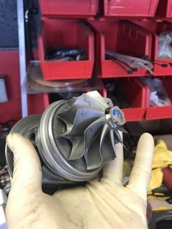

The new CHRA
And the new Twin-Scroll housing & turbo assembled! This is exciting!

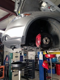

PRETTY!!! Are those 3-Piston front AND back?
Trigger has been pulled. Which means my red ST40 calipers could be going up for sale soon. All you would need are the rotors and caliper mounting brackets. I can give a GREAT deal on these calipers... but more on that later.
No, the pic is just showing what a BBK looks like in a Trophy finish. StopTech's FX35 BBK is a 4-piston front-only kit and uses the stock rear caliper. The fronts are the ST40 calipers - and I will be changing them to the STR40 calipers.
Piston sizes are 44mm/44mm and caliper width is 32mm, for use on the StopTech 355x32 slotted aerorotors.
What about upgrading your rears to the 2nd Gen BBK? I know it won't do much, but turbo had those kits to make it possible to put them on the 1st Gens...
Being a StopTech program manager... I know my brakes enough to know I couldn't make a mod like that without first doing some engineering. The balance & bias of a brake system is very purposefully tuned from the factory and usually has a non-adjustable bias valve installed at the master/booster. Take a caliper from another car and bolt it onto yours and you change the balance of the system which could be VERY dangerous. Locking up the rear wheels first in any situation is the way to start an immediate spin. Worst thing that we can do in performance driving. So while some guys might be using this setup without incident, there could be some dynamic situations (say.. under boost?) where braking has been compromised and I've already lost one turbo FX. Just saying.

Those are PRETTY calipers!!!
I see what you're saying about the dynamics of the brake system, but if the BBK upgrade for the 2nd Gen FX can bolt onto the 1st Gen, the weight distribution, wheelbase, and most measurables are almost identical from 1st Gen to 2nd Gen... I'd agree with you that it could potentially be dangerous if it was a brake system that was ported over from a G or another car though... And locking up the rears? Isn't that what the VDC and ABS there for? Theoretically it should release the brakes if one wheel locks up... In real life, this might not happen fast enough to get you out of a spin once started though... I'm just speaking purely hypotheticals though...
That's the thing about the brake system - we don't know the ABS VDC sensitivity, range and programming and what physical changes might take the system out of range for the ABS sensors. ABS can't function with just anything thrown at it so if the caliper force outputs are vastly different from stock, ABS and VDC simply return an error and don't understand what they are seeing. You would get a dash light... but maybe not - and that's what makes it dangerous. Even if ABS did function "correctly", you will not necessarily have improved stopping distances with the different rear setup. Until the engineering has been done, trial and error is really just anecdotal evidence and can't be considered fact, but definitely do contribute to our understanding of the system.
