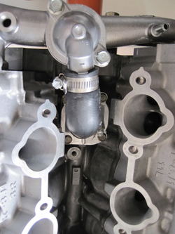

Talking with the installer, we decided to add in the pathfinder cooling modification. This is a cast pipe & fittings that route coolant to the rear cylinders. The Nissan Pathfinder uses these additional parts to address the engine towing load. In my case, it's just "cheap" insurance for my built motor.

Rev-up oil pump, VQ35HR head gaskets & pathfinder cooling modification:

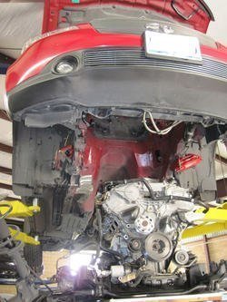

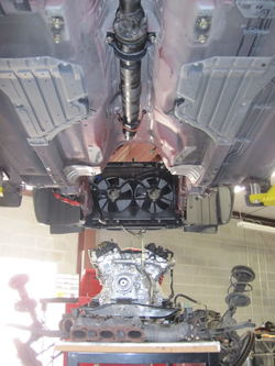

From the front looking back:
From the rear looking forward
Looking up into the engine bay:
