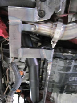

Factory cross brace. During the custom install, the factory cross brace interfered with the hot side piping. Powerfab modified the brace to retain function.
Notice a mounting bracket attached to the exhaust. Right now that's causing vibrations at certain rpm ranges. For a very long time both the shop and myself thought it could be the turbo causing vibrations but last month we isolated the turbo and discovered it was not causing any noise at all.
The noise is no big deal - it's not that loud or anything. But it's an annoying little detail that I know about and plan to take care of. Been talking to the shop about removing that bracket, then adding another exhaust hanger in the trans tunnel. I want to use an OEM rubber isolation mount. Taking care of that intermittent vibration is about the last thing I can think to "fix" from the original build. Other than that the setup has been performing perfectly since I installed and reflashed the new stock ECU.
