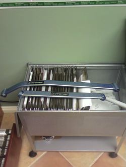

for those of us who are mechanically inclined, but maybe not so much automobile inclined, can you maybe point out in the picture which washers you are talking about?
No problem.
Both bars are attached to the sub-frame at alignment points.
The bolts have cam washers in place for adjusting the alignment specs. To put the bars on you have to take the nut off, the cam washer may or may not move when you loosen the nut but will more than likely move when you go to tighten the nut back down with the bars in place.
Mark the cam washers position in the keyed area before loosening the nut, this is just a precaution, and I'm not trying to scare anyone from doing the install yourself.
