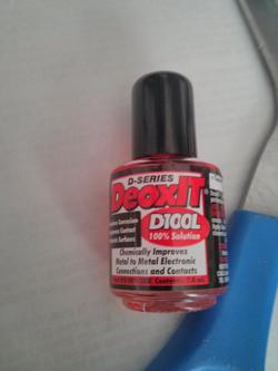

Just did it again last week. Cleaned the contacts and adjusted the needle(level unit and fuel pump). Finally the gauge works as it should. This time I was using this stuff to clean the contacts and the needle:
DeoxIT D100L
has anyone else tried this? or any other contact solution that may help deter (or at least delay) the problem from reoccurring? is there any kind of "grease" that could be applied to keep a barrier between the contacts and the gas, that wouldnt get eaten up by the gas???
