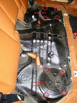

    To begin, remove the rear seat by pulling on the black ring at the bottom edge of the seat and
    lift the seat. Remove the seat and the flimsy insulation sheet.
    To remove the access door to the gas pump assembly and sender, use a philips screw driver and
    turn the black plastic locks in the direction imprinted on the lock.
    I find using a pliers is much easier than a screw driver
    Start with the sender unit located on the driver side rear seat.
    Undo the six 8 mm bolts, unplug the electrical connector,
    remove the fuel sender retainer ring and lift the send unit out of the tank.

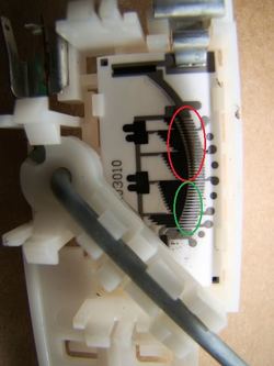

    Use a flat head screw driver and gently pry on the hooks to expose the part that needs to be cleaned.
    In this pic the part in the red circle is dirty. The part in the green circle has already been cleaned.

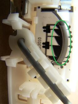

    To clean, using the eraser, gently rub the black deposit off the silver leads.
    All clean up. Move the floater arm to the center and pop the plastic cover back on.

    Now start to work on the send unit that is attached to the fuel pump.
    The fuel pump is located on the passenger side rear seat.

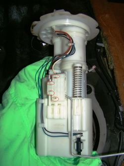

    To removing the fuel line, squeeze the white tab and pull on the fuel line to separate them.
    There will be a little squirt of fuel when they become apart. Have some rags handy!
    Update 07/12/11:
    If your tank is full, you may need a cup/pan to catch the fuel as it will continually dripping
    from the disconnected fuel line.
    Unplug the electrical connector. Undo the six 8 mm bolts to remove the fuel pump retainer ring.
    Note, when you undo the last couple of bolts, hold the retainer ring as the fuel pump will try to pop out of the tank.
    Carefully lift and work the pump assembly out of the tank.

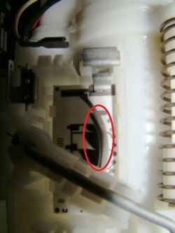

    Dirty sender leads. Again using the eraser, gently rub the black deposit off the silver leads.
