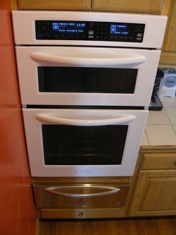

I would so do this, but my latest mod money went to a warming drawer & a couple of front loaders . . . bahahahaha
Appliances aint cheap :err: but at least I'm eating well

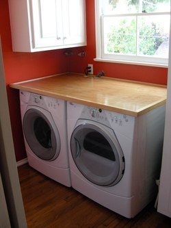

I Made the table on the washers . . kinda proud of that one
