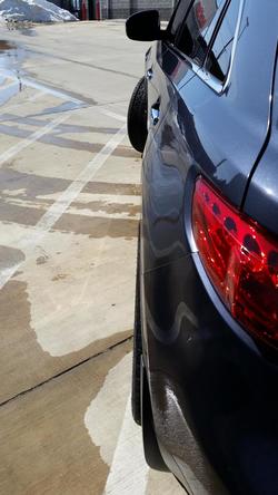

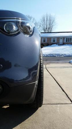

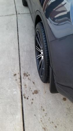

All done. It was a bit of a PITA to get the new studs installed in the front, but it worked. 10mm spacer in the front and 15mm in the rear. Zero vibration on hubcentric setup. Wider track feels stable and responsive. Here's the final setup...
Now waiting on my h&r springs, that should pull everything in nice and tight to the fenders. I will be removing the cross bars on top for the off season since I probably won't be snowboarding any more this year.
---------- Post added at 03:37 PM ---------- Previous post was at 03:16 PM ----------
I am now 70mm wider in total in the rear and 60mm wider in total in the front with this setup.
Front poke:

FYI:
