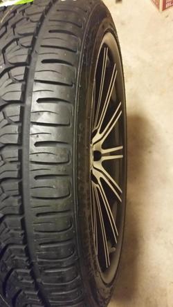

Nope, these did NOT clear the BBK. Off to get some spacers.

Yeah, you're not kidding. Kinda pissed actually. Even with a 5mm spacer it's gonna be VERY close to the caliper. I'm a tad nervous that they may not work even with the spacer. It's really the wheel design since the spokes are so damn deep and straight. If it were just a bit more of a curve I think I would have been fine. The poke is now going to be +25mm over the stock setup. This will be very close to flush on the front and just a hair under flush in the back if my math is right. Might have to go 10mm for the rear down the road. Want to see how these 5mm spacers at all 4 corners fit up first.

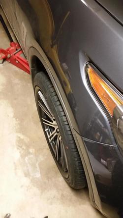

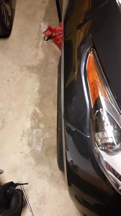

The issue? The flipping wheel still hits the BBK. What's worse, the wheels poke too much with the 5mm spacer:
Now I am bent. Going to a 10mm is going to be hella-poke. Add in the h&r drop and I am going to have issues hitting the bottom of the fenders. Go 10mm? Doubled up 2 5mm spacers (10mm) and it clears fine.
For those keeping score at home, +40mm offset wheels in 22x10.5 with BBK is no beuno. +30mm offset is the way to go. But you will have poke beyond flush.

I dont think the poke is that bad at all. Go for 10 ;)
F it, going 10mm spacer front, 15mm rear. PEEJ's setup looks sick, and he has no rubbing issues with his drop and he's set even wider. Go big or go home. Going to remove the brakes for a repaint while I wait for the new spacers and springs to arrive. 4 5mm spacers going up for sale shortly.

Silly question, but was that picture showing poke taken at drive height? I see the jack under there and can't tell from the angle. Side pic shows it jacked up. If it's not at drive height, the look won't be accurate since the wheels will camber in some on the ground. My tires poke out 1.5" + front and back when the FX is jacked up, but are flush at drive height because of camber.
