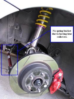

Kinetix arms do not have anywhere to bolt the shock as they are designed for a Z or G where the shock bolts to the top of the spindal

This is true coilover setup on a 350Z. The coil has to sit "over" the shock. Advantages are that the suspension pieces are in line and the spring rate can be better tuned vs. having the spring sit inboard and separate from the shock. Notice the spring bucket is gone.

Mike, those camber arms (Kinetic or SPC) will not work in our cars. I would suggest to stop the order. Our rear shock cannot be mounted onto those arms you mentioned. There is nothing to try. Just get two 72265 camber bolt kits and slot the sub-frame with the provided template. If you have the GTSPEC Rear Tie (the short straight one) brace, you will need even longer bolts than the one that came with the 72265 kit. Jeff (J3FF3R$0N)had made some custom longer bolt made awhile ago. He may still have some. I have an extra set back when he made them. If you need these longer bolt (longer then 72265 kit) let me know.

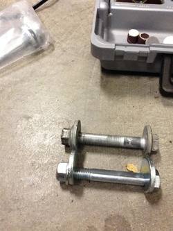

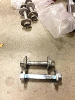

Here's the 72265 kit bolts versus the spring bucket on top, and shock mount tie on the bottom. It did work for the shock mount tie even though it's longer, and that's without the gtspec brace. I think it would have worked with the gtspec on the spring mount also, but it was harder to access the nut after I had to elongate the gtspec mounts. I didn't feel like taking off the exhaust again to try a better angle because I had just taken the time to align it all.
OEM top vs. SPC bottom (spring bucket)
OEM top vs. SPC bottom (shock mount)
