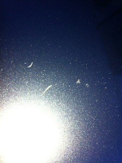

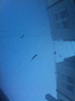

Can anyone chime in to help me? I got these scratches on my hood from parking in the city. It looks like someone was trying to load something in their car and hit my hood.
The biggest scratch you see there is about a DIME diameter and is also the deepest.
---------- Post added at 05:19 PM ---------- Previous post was at 05:17 PM ----------
Can the Dr get this less noticeable ?
Those look pretty deep. Buffing it won't do anything for them. Some touch up paint will help hide it but you'll still know its there.
