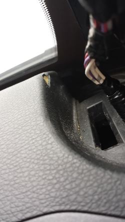

Lol you guys think this is a common issue only on the 1st gen FX? Well think again my 1st gen G35 has a similar issue with a cracking dash right where it meets with the A pillar. A stress cracked formed causing the vinyl to chip off. It has it in that same exact spot on the driverside too. I looked on the G forums and there is a huge thread dedicated to this issue. Smh I called infiniti consumer affairs today:
Luckily I caught this early on my G35 because if they dont fix it ill have it repaired before it spread anymore. Luckily this is a part you dont see though.

I put my sunshade visor up.. come back and when removing the visor.. it sticks to my dash... causing the dash to peel.
...will they still replace it?
