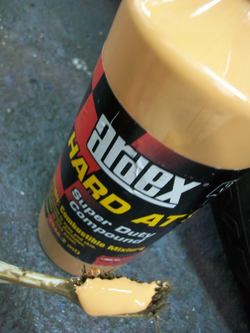

baked on brake dust on every little corner of each wheel
Ardex Hard At It Super Duty Compound, a toothbrush & alot of patience took care of that

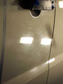

bef driv door
after wash & claybar

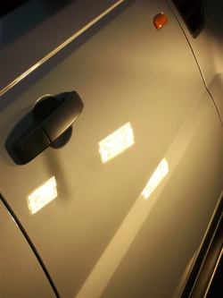

aft pas door, driv side
aft wash & clay bar, compound, polish

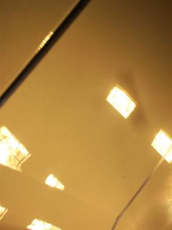

bef front of the roof
aft wash & clay bar

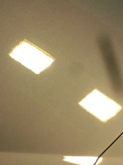

pas side by the sunroof after wash clay bar, compound, polish
no sealant or wax applied yet

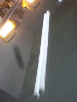

hood with fluoroscent & 1000 watt halogen lighting

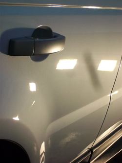

front pas door
33
front pas door close
34

3 halogens on the hood
one of the 500 watt bulbs burnt out before i took this pic
39
up close

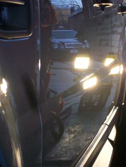

one of my fav pics! drivers door!
42
