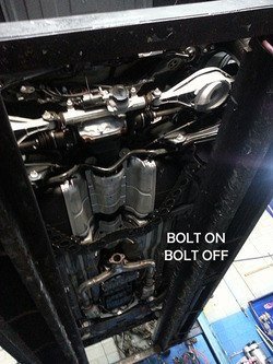

The car went into a performance shop where we spent the day building a custom exhaust solution. Firstly the stock exhaust was removed and then the resonators. As pictured, straight pipes were fitted from the existing flange and painted black. Which leads to a set of X-Force Varex High performance mufflers which have an electronic butterfly mechanism inside. This allows me to change the exhaust note and volume as I see fit from inside the cabin. I also taped and painted the rear of the stainless steel muffler because it was simply to flashy, I'm going for a more subtle appearance...
All of the existing mounting points were used and the construction (straight pipes) will allow the future addition of two High flow spiral resonators if there's too much drone in the car...

Hiya! We considered it. We concluded that having an X-Pipe wasn't going to make a noticeable difference in this setup. I didn't want to touch the upper exhaust system or cut any of the factory pipes, tampering with the upper section can in some cases have a profound effect on warranties. This system is a true bolt on, so when I sell the car it'll be as easy as removing the bolts from the first flange gasket after the catalytic converters and swapping the system over with the stock rear and mid section; which haven't been altered whatsoever.
