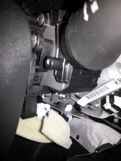

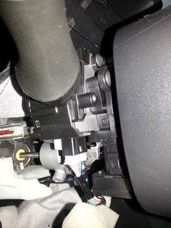

Step 1 - Verify bracket and wire harness requirements
Fig A - Showing OEM paddle mounts, no bracket necessary (Wire harness may be required):
Steering column view - Left
Steering Column View - Right
