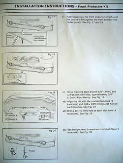

Here are the instructions that come with the Factory Aero Front Spoiler.
I will post a few actual install photos later

Thanks for instructions. I think I would let dealer do it,even I am pretty handy.
If they f* up anything,then they order one more set. But if you drill wrong or get gap,you screwed,noone will cover it for you.
I did the final Installation today. It is really quite easy, just take your time.
Here are a few install pics
Template taped on to locate two 1/4" holes to be drilled for End Cover
Holes have been drilled and 2 Spring Nuts installed ( must do on both sides)
Template taped on to locate slide on retainers ( there are 3 templates and each one locates 2 retainers)
Next you must tape the tabs back on the two sided tape that is on the Spoiler (8 locations)
Remove 2 lower bumper bolts on each side and discard The kit has new longer
ones.
Slide spoiler on and install 2 new lower bumper bolts loosely on each end.
Make sure there are no gaps around fog lights and front bumper and tighten the two screws on each end
Install End Cover on each side as per instructions
Remove double sided tape liner on 6 retainers and end sections and apply pressure.
Push up on bottom of Spoiler to contact bumper and drill 1/4" holes as per instructions on 4 spoiler attachment tabs.
Clip installed in Attachment Tab (4 places)
Finished Front View
Finished Side View showing End Cover
