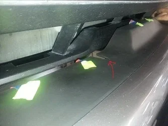

GEE50FX need help with front aero kit, I'M having a small problem with a gap around the fog lites on both sides
did you have that problem when you install yours and how did you fix it
I'M guessing if i make these groves deeper it myth fix that problem or is there another
solution

No I had no problem, I installed it on my 09FX and my 2010FX and both went on perfect with no gaps.
