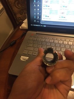

So pissed! And it's a weekend. [emoji35]59f040cf3d8ae6c20a095e05f83d4ac2.jpgb8e29074afdd459d580bab97363ee02e.jpg
---------- Post added at 09:42 PM ---------- Previous post was at 09:29 PM ----------
While driving home today, I heard some nasty crunching noise like something was moving on my suspension parts from the driver's side. I was about 50miles from home. I pulled over checked my struts, shocks and CO and did a visual on the wheels but did not find anything wrong. The underbelly pan was secured so no indication of any issues there. When I arrived home, I jacked up the car and checked carefully all suspension parts and found the culprit. I think a lug nut or two on my driver's side came a little bit loose causing a little bit of a play. I was about to remove the lug nuts when the flimsy McGuard wheel lock key split open.
So the FX is going to be grounded till I will purchase a replacement.
