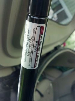

Just replaced my hatch shocks and WOW! I don't know if these replacements I got are stronger or if mine were blown when I bought my FX but the difference is amazing! Its like a power assist hatch all of the sudden. I only have to lift it about 10% of the way and the shocks take over, opening it fully and very quickly.

These:
$65 shipped from their website.
Thanks for posting this! My hatch has to be lifted alllllll the way up, not quite sure why. Just bought me a set of these, thanks to your post. Here's to hoping it does the trick!!

It will do the trick, but one word of warning: the OEM tokico shocks have an internal retainer clip on the ball joint ends that cannot be removed. You have two options; Buy new hardware (the brackets that attach to the car and the hatch), or carefully cut the ends off the OEM shocks to reuse the old hardware. I chose the latter and the whole project took about 15min and 3 Dremel cutting wheels.
