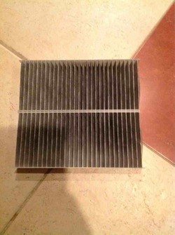

work on the fx today and change the in cabin filter thanks to Fire0nic3FX DIY boy after 30k some miles it wasn't tha bad as I expected
Sent from my iPad
Sent from my iPad
Whether it looks dirty or not isn't always the case. Sometimes the filters may be also causing bad smells in the vents which is also a sign the filters are no good. It's why I keep mine changed once a year.
That was also the reason why changed it :tongue (2):
