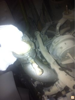

water gurgling noise after coolant change

I tried all the solutions above and I still got air bubbles. I ran the car without the cap on and even burped the air release valve. Believe me I tried everything. The real solution is that the air bubble noises go away after like a few weeks of driving and the coolant level settles in the tank.
I think the reason why you never had an issues is because you never did a full drain on the car. I tilted the car sideways and removed the coolant plug thats on the actual block itself. If you just drain it from the radiator you're not going to get all of the coolant out. Since I did a complete drain and fill all the lines and block and radiator were completely empty which resulted in a more difficult time bleeding the system.

The issue of trapped air is i think because there are too many valves and ways in the cooling system, there is the thermostat and the water control valve, there are 3 circulating options for the coolant:
1) Thermostat closed - water valve closed > coolant circulates only around the cylinder head and heater
2) Thermostat open - water valve closed > coolant circulates around the cylinder head, radiator and heater
3) Thermostat open - water valve open > coolant circulates around the cylinder head, cylinder block, radiator and heater
