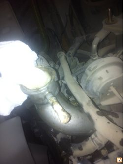

Never mind that, I changed the coolant today and used compressed air to push out as much old coolant as possible via the air relief plug and the drain plug. I replaced the old coolant first with fresh water, gave it several revs, and then replaced it once more time with a fresh coolant. All went well.
The connection to the reservoir tank right at the filler neck was plugged off completely with stain and dried up coolant all around it, I had that cleaned up and fixed.
