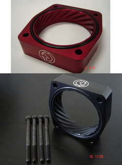

Well here's a new one. Throttle body spacer?!? Yep . . & was skeptical too, but what the hell . . for a 90 some odd bucks, I figured I'd give it a go.
This is DaveO's neat & cheap new mod, & it seems to add a little bit to my setup, but not huge amounts. It does alter the A/F a bit before a tune as you can see below. After the tune, I cant really say what additional gains were made. I didnt notice anything on the buttdyno, cuz the gains are not huge, but probably more collective with my other mods, & it does make a really cool whizzing sound, like a spooling up sound.
I never really anticipated it to add that much, but it's really a sure win little gizmo that probably adds probably more than all those intake tubes we spend so much time discussing.

There is a 7 HP gain to the wheels with the spacer alone, no tune.
