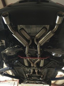

Completed ARK GRiP exhaust and GTSPEC rear lateral brace install:

Just nipped about two inches off the resonator tubes closest to the x-pipe flanges. Reused the original stainless flanges. Extremely professional job, too. The welds are perfect. Can't even tell they were ever cut!
