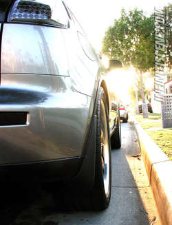

Why wouldn't it clear the stock brakes? Most wheels with big lips have a somewhat cheater face. Bowed in the center and the spokes reach out and back to the barrel for caliper clearance.
I'd be more concerned with rubbing the front strut body. 25mm is almost max inward with tires with bulge, you can go more but the sidewall needs to be a bit less bulged.
this is a lipless wheel. It's bowed in the center as well but don't know man, I'm really confused here.. I roughly measured the clearance from my front calipers to the inner side of stock 20s and it was less than 27mm.. If this size reduces by 27mm, I thought it wouldn't fit.. Also, the tires I'm planning on using are 275/45/20 size. It didn't make any bulge with my old OZ Canyons (20x9.5, 40 offset):
I think it wouldn't bulge with 10 as well.. As long as the calipers fit, I'd rather get 20s (weight concerns) than 22s and don't worry much about how it'd look awesome with 22s.. I can always get 295/40/20 tires to reduce the sidewall..

275 on a 9.5 will not bulge. That would fit well. 285s seem to be perfect on a 9. 305/35s on a 9 will bulge like this (with Pirellis)
