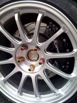

Hi just to clear up one more thing with the floating rotors.
The 13 and 14 inch DO NOT come with floating rotors but they are available for $100 more.
You would not need them especially on an FX i dont think you'll be doing any road racing or drifting. Although the rotors are still 2 piece. I have a picture of a 14 inch here from an FX customer, direct sunlight so its not great but decent. Also some other random pics for you.
14 inch on FX

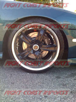

13" on my 240
