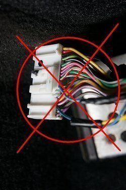

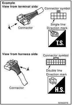

FX45Chicago (Chris) took his Dice MediaBridge out of the center console and updated it with the latest firmware for this iPhone 5 support. While, I'm working on getting the KP Technologies MX20 Fog Light module installed and replace the leaky thermostat cap with a coolant temp sensor for the e-fan mod. Got the thermostat cap installed, but got hung up on the KP fog light module. I think I might need glasses pretty soon. I miss interpreted the included diagram on a DIY from the Org. The diagram was view from the back of the harness for the wire location. So needless to say, I tabbed the wrong wires. :embarrassed: Once the fog light module wired up, Chris would like to use it to control on/off of the fog and his LED halos.

Note the double lines around the connector indicates that you view it from the back (the harness side).
Tabbed the wrong wires on the BCM connector! :embarrassed:
